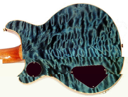

figured maple can be had for a decent price on e bay(if not insanely figured).
why not add another piece of figured maple to the back of the guitar? like James Jaros does?

[QUOTE=vachterm] figured maple can be had for a decent price on e bay(if not insanely figured).
Udi.[/QUOTE]
I was thinking the same thing. I think you will get the "most intentional" look taking this approach.

I would suggest adding a back to the guitar. That's the way I do it anyway, and it allows me to make a center "core", where I can cut out the inside right on the bandsaw. I enter the inside right at the strap button, and then glue in a contrasting wood at that spot, it looks good when it's done. Cut out the inner chambers, and then use a top and a back. This allows you to easily make a back control cover before you glue the back on as well.
